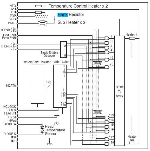

servisny manual napsal(a):
BJ cartridge Detection with head rank and head temperature sensor
Na pine RANK (TOP) je s cartridgom asi 0,59V, bez neho 0,61V. Skusil som to stiahnut dolu a detekcia presla!

Rank je odpor zapojeny druhym koncom na zem. V mojom pripade 1K024.
BJC-2000 service manual napsal(a):
Rank resistor
To execute optimum heat control of each BJ cartridge, production-related deviation
in heater characteristics is classified into 13 types which are identified by changing
the rank resistance. From the MPU & Printer Controller's analog port, the MPU
detects the different rank resistances as voltage values and converts them from
analog to digital for detection. The heater's characteristics are thereby recognized.
This printer detects the presence of a BJ cartridge by the two resistance values of
TOP (pin 9) and DIODEA (pin 10) of the cartridge signal contacts. When the
resistance value of TOP is 750 or less and that of DIODEA is not zero , the printer
decides that the cartridge is installed.
V servisnom manuli BJC-2000 je aj pekna schema hlavy BC-20, ktora je asi podobna. Je tam okrem rank odporu vidiet aj dve diody v serii na meranie teploty (preto som ju nenameral).

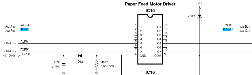

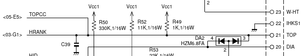

Otazne je, preco nefunguje ta detekcia rank. Odpor R49 (1K) a rank odpor tvoria delic, signal HRANK ide do analogoveho multiplexera a analogoveho vstupu procesora. To by bolo ale prilis jednoduche. Je tam odbocka TOPCC, cez ktoru sa to uzemni cez IC15 (UPA2003GR) Shocked Ovladaci signal TOPC vychadza z procesora a je stale aktivny...

Odpojil som pin 2 z IC15. Napatie na HRANK vyliezlo na 2,55V. Detekcia stale nefungovala.
Zapojil som dve seriove diody medzi DIA a DIK. Detekcia stale nefungovala.
Pripojil som na HRANK odpor 470R na zem. Detekcia konecne funguje!

Pripojil som naspat signal TOPC na pin 2 IC15, detekcia stale funguje.
Jeho vyznam som nepochopil, ale osciloskop aspon ukazal funkciu. Procesor tento signal s frekvenciou 10Hz vzdy na ~290us deaktivuje a zjavne vtedy meria napatie.
