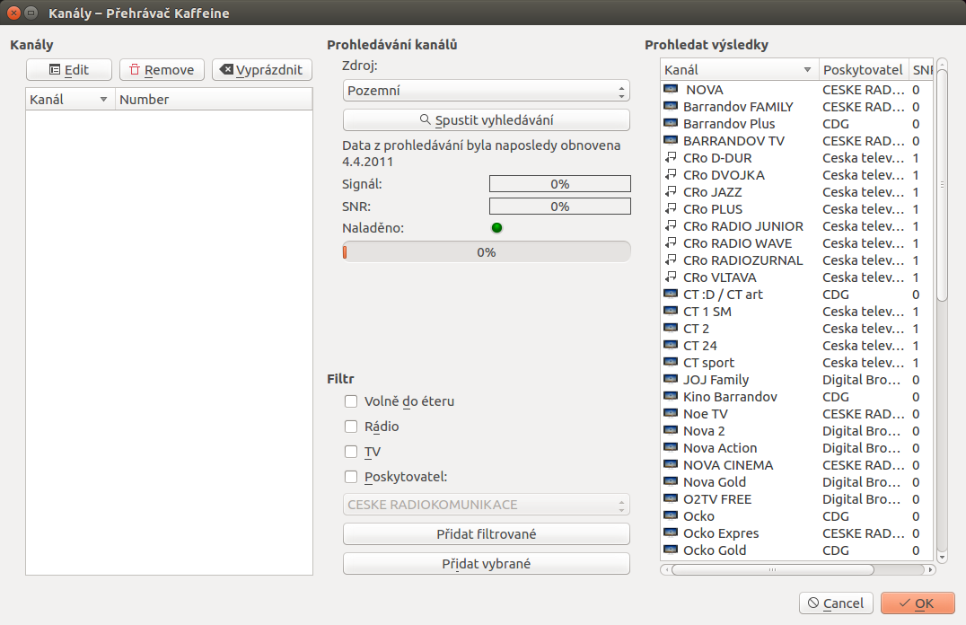

w_scan -c CZ výstup (mělo by to najít programy, ale nic nenajde):
570000: (time: 00:24.186) signal ok: QAM_AUTO f = 570000 kHz I999B8C999D999T999G999Y999 (0:0:0)
Info: no data from PAT after 2 seconds
deleting (QAM_AUTO f = 570000 kHz I999B8C999D999T999G999Y999 (0:0:0))
Standa99

Musíš si to hlídat ve výpisu dmesg, např. můj tuner, kterému chyběl firmware dvb-demod-mn88472-02.fw:
kód:
[ 2439.266993] usb 1-2: new high-speed USB device number 4 using xhci_hcd
[ 2439.802562] usb 1-2: New USB device found, idVendor=15f4, idProduct=0131
[ 2439.802563] usb 1-2: New USB device strings: Mfr=1, Product=2, SerialNumber=0
[ 2439.802564] usb 1-2: Product: dvbt2
[ 2439.802565] usb 1-2: Manufacturer: astrometadvbt2
[ 2439.875193] usb 1-2: dvb_usb_v2: found a 'Astrometa DVB-T2' in warm state
[ 2439.953395] usb 1-2: dvb_usb_v2: will pass the complete MPEG2 transport stream to the software demuxer

[ 2550.348068] mn88472 1-0018: Direct firmware load for dvb-demod-mn88472-02.fw failed with error -2
[ 2550.348075] mn88472 1-0018: firmware file 'dvb-demod-mn88472-02.fw' not found
!_důležité jsou poslední dva řádky_!
po dodání firmware:
kód:
[ 4027.864297] mn88472 1-0018: downloading firmware from file 'dvb-demod-mn88472-02.fw'
Potom w_scan funguje (částečný výpis):
kód:

177500: (time: 00:07.448)
Scanning 8MHz frequencies...
474000: (time: 00:25.487)
738000: (time: 02:29.972)         signal ok:   QAM_AUTO f = 738000 kHz I999B8C999D999T999G999Y999 (0:0:0)
        QAM_AUTO f = 738000 kHz I999B8C999D999T999G999Y999 (0:0:0) : updating transport_stream_id: -> (0:0:275)
        QAM_AUTO f = 738000 kHz I999B8C999D999T999G999Y999 (0:0:275) : updating network_id -> (0:12560:275)
        QAM_AUTO f = 738000 kHz I999B8C999D999T999G999Y999 (0:12560:275) : updating original_network_id -> (8395:12560:275)
        updating transponder:
           (QAM_AUTO f = 738000 kHz I999B8C999D999T999G999Y999 (8395:12560:275)) 0x0000
tune to: QAM_64   f = 738000 kHz I999B8C23D0T8G4Y0 (8395:12560:275) (time: 07:20.232)
   service = CT 1 SM (Ceska televize)
   service = CT 2 (Ceska televize)
   service = CT 24 (Ceska televize)
   service = CT sport (Ceska televize)
   service = CRo RADIOZURNAL (Ceska televize)
   service = CRo DVOJKA (Ceska televize)
   service = CRo VLTAVA (Ceska televize)
   service = CRo RADIO WAVE (Ceska televize)
   service = CRo D-DUR (Ceska televize)
   service = CRo RADIO JUNIOR (Ceska televize)
   service = CRo PLUS (Ceska televize)
   service = CRo JAZZ (Ceska televize)

Aha, ten konec v tom předchozím příspěvku nemáš. Podle výpisu dmesg máš vše dobře, pokud by byla chyba ve FW, tak by to snad vyřešila nějaká jejich aktualizace.
Před dalším w_scanem bych zkusil ten tuner odpojit a znova připojit z USB.
Popřípadě ještě vyzkoušej Kaffeine.

Já mám přístup k raspberry-pi2 přes openssh a na něm usb evolveo. Musel bych připojit monitor a doinstalovat kaffeine a to se mi moc nechce. Mám sice dost ram (1G), ale cpu je armv7. Možná i tam bude chyba. No nevím, kaffeine na tom bude úplně stejně. Myslím, že když to nenajde proud dat tak, je to buď chyba nedostatečného signálu ( a ten hlásí ok), nebo to znamená chybu v ovladačích, že ten proud dat prostě vede jinou cestou než u verze 0572:c689 (MYGICA_T230C).
Vzhledem k tomu, že ve zdrojích programu w_scan, je PAT na adrese 0x00, tak to může být cokoliv, nebo ne? Při nejhorším ho použiji ve Windows, ale bylo by to pěkné, kdybych ho mohl v linuxu pod raspberry-pi streamovat do lokální sítě. Smile
